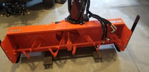

Well yesterday I did a little snow blowing practice. It is definitely going to take a little time before I become proficient with the controls. What I do not like when the snow blower is in the up position when you go to lower it, the snowblower slams to the ground. You would think there would be some type of a flow control in there to slowly lower that piece of equipment. Remembering to put the float control on will be another thing to get used to. I found out the snow blower shoots dirt out as good as it does snow when I forgot put on the float control it dug my sod up very well. Another thing I have to get used to it is such a powerful piece of Machinery I have to keep my eyes everywhere because if you hit something by the time you feel it it will damage your machine. All in all this is going to be a fun piece of equipment to clean up my driveway with. I will review this some more once I get a decent amount of snow.

You might want to build one of these carts it makes it so much easier to put the snowblower on the machine

I wish I had that much snow to plow. I have a question for you when you lower the snowblower does it lower slowly or does it slam to the ground? On mine when you press the button to bring it down it comes down quick not a nice smooth motion. I'm just wondering if this is normal or not.
you can solve the quick down problem by taking the quick connector off of the hose that controls the down side of the cylinder and putting a small orifice in then put the connector back on.
Do you mean the male connector needs to be swapped out with one with a smaller orifice? Or do I somehow modify the female connector? How do I make the orifice orphis smaller could you please explain it a little more detail. You would think they would have some kind of flow control like they do for pneumatics. Is this normal operation for hydraulics because if it is not normal operation I will take it back to the dealer it is still under warranty?
no. you can buy a small SS disck that has a tiny orifice in it. you take off the tip on the return line slip in the disc and then replace the tip.
