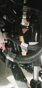

So this is not normal operation? Do you think Kubota Dealership would have a fitting with smaller orifice. I will definitely have to check out my quick disconnect to see how to take them apart to put a disk in there with a smaller orifice and also measure of the existing office to see what size it is. I guess this would be trial and error on the orifice size until I can get it to slow down
my guess is that there isn't an orifice installed. the fittings will just unscrew with a pair of wrenches. if you look at the fittings closely they will probably have some numbers embossed into them. that would be a part number that you can google probably to get the thread spec and dimensions so that you can order an appropriate orifice adapter. is the blower power up and gravity down? or power both ways?

I have two hydraulic lines going to the cylinder so I would imagine it is power-up and power-down. Do you think I can take that fitting off where I have the arrow drawn take it apart there and put a fabricated stainless steel discs in there? The last picture is of the lower and lift cylinder it has two hydraulic lines connected to it

no sir i wouldn't use the disc type at all since you have power down. i wouldn't place the orifice on the tractor side because it will affect every attachment. i would put it in the hose from the attachment side
