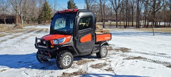

Not much of a traditional winter here in Maine (so far). Lots of wind though and the coastal areas are suffering. I’ve only plowed once and that was only a few inches. I’m still getting used to the Boss V-Plow and the x1100c (which I’ve named “Little Joe”, don’t ask me why). But this light bar was a great add since this time of year it’s still pitch dark early when I want to clear the driveway. The pic is for interest (sorry if it’s a repeat). Happy New Year!
