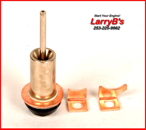

I just went through this with my 2014 X900. Turn the key and it would just click. Priced a starter and WOW. Took the starter apart and could see the contacts were shot. It is the Denso. Found the contacts kit on Amazon for about $40 delivered to my door. Fixed the problem.
As others have said, Use the starter identification info off your starter and do a search. Several choices resulted for me. Contacts were a simple install.
