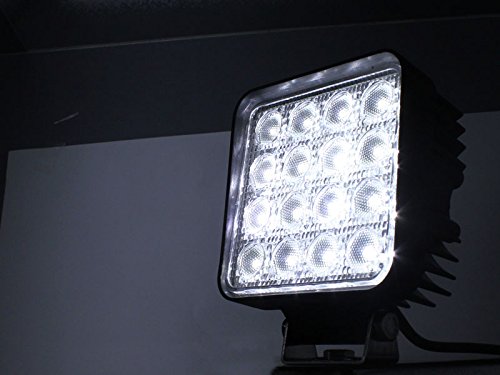

Sorry guys, I have been out of touch for a long time. I finally got my password reset. Anyway, these are the lights I got from Amazon.
https://www.amazon.com/gp/product/B00G620ZVU/ref=oh_aui_detailpage_o03_s00?ie=UTF8&psc=1
They are Nilight 1260lm, 18 watt units.
