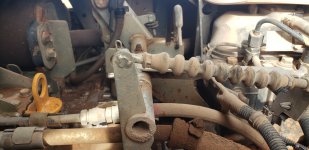

Kimsdado
Picking up a new cable today. I will then go through your process. I was not pushing the pedal far enough and even now with the bolt all the way down under the pedal the detent just barely moves off the bell crank. Could you send me a picture of what your detent looks like at full throttle?
Kimsdado
The black rolling wheel comes completely out of the detent and moves out on the tongue almost to the end in relation to the detent. I figured it was supposed to do that. I am assuming it is in this furthest reflected state that the rod attached at the back end would be pushing the HST lever to its full throttle position. My black wheel does not even get out of the detent with the pedal completely to the floor. I have the cable threads adjusted all the way out to the maximum. I will be pulling the cable and laying it beside the new one to see just how stretched it has become. It will be interesting. Thank you for the picture. Additionally it does not look like it takes very much pulling on the lever to move the wheel out to that final position. Thank you for the photos. I have a better understanding of the mechanism. I am also assuming it is at this position that I would adjust the floor bolt up to touching the pedal.

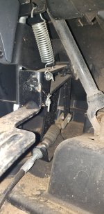

Kimsdado
This is what I did. Cable taute with pedal at highest resting state and detente in it's seat. Bolt was all the way down and the pedal moved all the way to the floor without binding anything. It still did not pull the black wheel or roller out to the end of the tongue (picture 3). The new cable and old cable were actually the same length but the old one was not pulling through the sleeve smoothly and actually froze when the temperature dropped into the teens a few weeks ago. I made the assumption there was moisture in the cable and also that there is likely rust on the cable. I am keeping the new one. Do you think the pedal may be slightly bent? Should the angle be 90? Here are pictures of components with pedal up and then the detent when fully depressed. It will now run a out 8 to 9 mph on the flat. Itnus I vious to me that the HST lever is not getting out to its full throttle range but the cable is pulling everything it can.

aurthuritis
The detent assembly looks ok. But just to be thorough i would disconnect everything including the peddle cable from the belcrank and make sure it will move freely throughput its entire travel length. Then with the cable unattached from the peddle make sure it will go all the way up and down without any interference especially in its highest. Look for loose broken bent parts on the peddle.

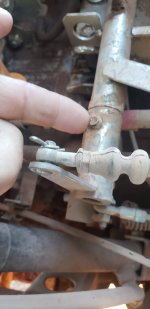

aurthuritis
Check this roll pin that the fickle finger of fate is pointing at? It may be sheared off or sloppy?

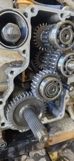

357blckhwk
Looks like things keep getting better.
This is the input flange and input shaft.
They look like they spin freely lol.
So I know I'll have to open the gear box, I'm afraid there's carnage I'm not ready for.
The input shaft in the transmission spins like a top when i turn it. Regardless of the gear selector position. Should that be the case?

357blckhwk
Well,
Heres a little something that might help someone.
This bearing and gear need to be pulled off before you pull the case apart.
Everything inside the case looks good. Nothing really jumps out at me as being a red flag, but i did find this
Any idea where these go?
