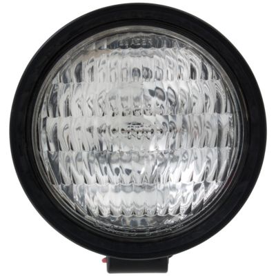

They look nice and i know are low wattage but how well do they shine out or let me ask how really effective are they distance wise? Im just curious is all.Ive seen many posts on these but have never seen how effective they are.I have these mounted on mine from Tractor supply. 1 mounted on rear for backup light and rear work light
0283844

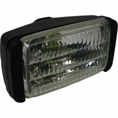

and 2 on the front for extended viewMounted on lower roof lip.They shine out more like spot lights and i like they way they light everything up way out far.
0283925

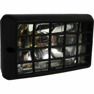

and 1 mounted on each side of the rops for alley or side lights.
0283941
Thay do pull some wattage but i like the way they work and would be open to leds if they did the job.
