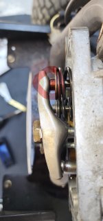

So, I was prompted to check the valve gaps. That could be an issue. I removed the valve cover and do a visual inspection first and notice that the intake rocker was EXTREMELY loose!
Having the adjustment specs I begin to Gap the Rocker and valves. But the intake adjustment nut I had to turn several more times than I did the exhaust. I adjusted the gap/lash on Both valves.
Thinking I was done as I start to clean the residual oil off the bottom of the case I noticed this circular piece of metal that was cupped. Immediately, I thought to myself, Rob you dipshit!πŸ€¬πŸ€£πŸ˜†
I took it out cleaned it off and knew exactly what it was. And that's why the intake valve rocker needed to be tightened down more than the exhaust valve rocker! (Pictures to follow.)
So this would explain the missing, extremely rough running and backfiring through the carburetor.
