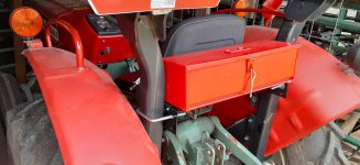

On the RIGHT fender (as sitting in the seat), near side in the pic below, remove or move backwards, the light on the fender. Then bolt a toolbox on the flat part of that fender.
iu
I said the right fender because your ingress/egress from the seat happens on the left side so putting it on the right, it won't be harder to get on the tractor.
On my tractor, I built a bit of a frame on the fender then set the toolbox on the frame. This makes it whereby I can swap out the toolbox or remove it for whatever reason then easily put it back in place.
The bungie cords hold it in place but also allow me to slide skinny tools between the toolbox lid and the cords.

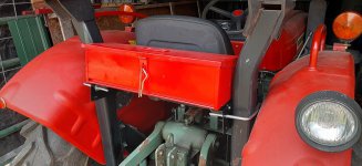

Do you have a bracket for hanging weights on the front of your tractor?
I put a toolbox there as well. Here's a pic of the cradle without the toolbox in place.
