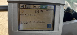

Hello , I have a premium John Deere 6930 with AutoPowr gearbox , but a problem is arising , it is always starting from the traction gearbox , it has been mounted by specialists more than 3 times , the maximum time it took was 20 hours of work and the traction box is always breaking, the last time I went to assemble it, start the engine and immediately heard it breaking ....
We went to measure the transmission box pressure and it was at 40 bar which is a high value, while the technician said that the transmission box is broken because it has a passage that increases its pressure.
I would like to know your opinion on this situation!
The tractor's on-board computer gives me the following errors:
PLC 221 328016.31
and
EPC 3 524176.19
