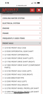

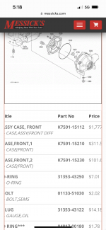

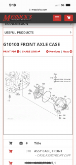

If you don’t have the WSM(service manual) for you Rtv you can find it online. I found one for mine that I keep on my computer and it was free. It will tell you filter sizes, how to tear down and put back together, etc…. I am in the same position as you, first time owner of a Rtv. I also use Massicks.com for looking at the schematic. It is easy to look at the parts and if you forget how they came apart it will show you how they go back together(done this many times. I will attach pictures to walk you through their site.
Hope this helps.
